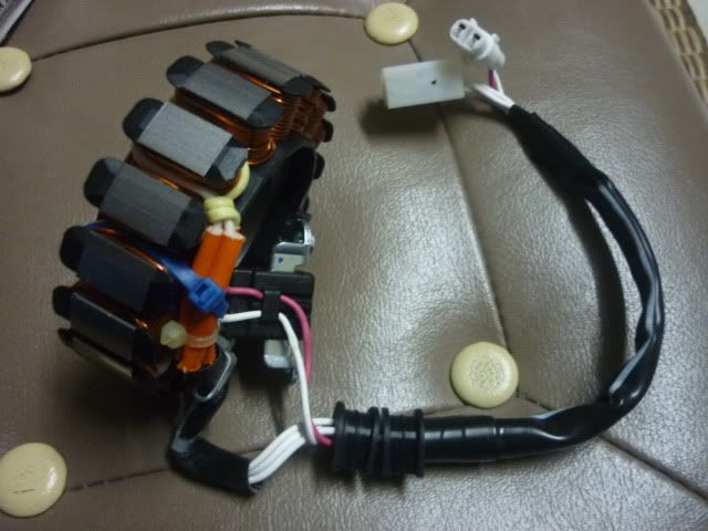

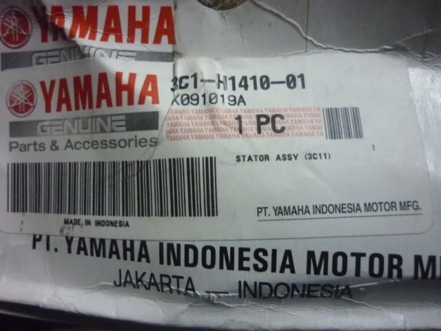

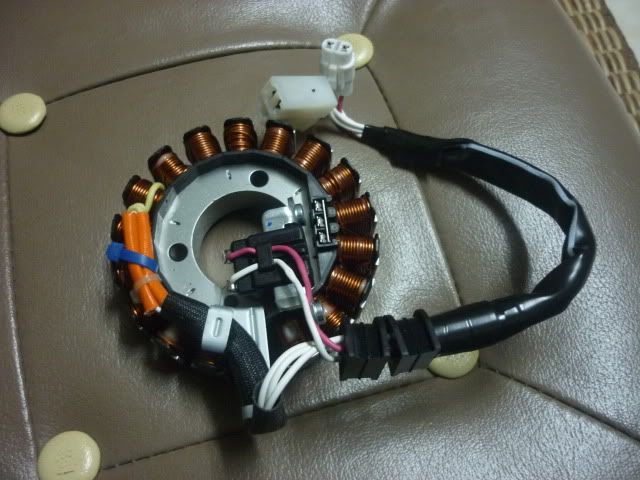

Post by taj on Wed Feb 03, 2010 12:43 pm
the purpose is like dynamo..item imported from indonesia
