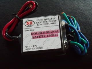

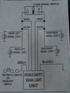

Post by maxchua Sun Oct 23, 2011 4:59 pm
RUNNING LIGHT RM50 - Page 2 P2020706
RUNNING LIGHT RM50 - Page 2 P2020726
wire biru(kotak)=wire kuning (manual)?
wire hijau(kotak)=wire hijau (manual)?
kalau terbalik pasang , signal function tak?
maxchua

Post by taj Mon Oct 24, 2011 12:07 pm
fungsi terbalik la...tekan suis kanan signal kiri yg nyala

Post by maxchua Mon Oct 24, 2011 2:41 pm
taj wrote:fungsi terbalik la...tekan suis kanan signal kiri yg nyala
i sudah pasang sama dng manual tu, tapi tak function bagi signal lo, kalau buka suis running light, dia function, terus tak boleh guna sebelah kiri atau kanan punya signal ? masalah di mana?

Post by taj Mon Oct 24, 2011 2:45 pm
ada yg silap la tu ....signal tak function because of wiring la...kat mana u yg u tap?kena tap di connector wayar dari panel kiri handle

Post by maxchua Mon Oct 24, 2011 2:59 pm
taj wrote:ada yg silap la tu ....signal tak function because of wiring la...kat mana u yg u tap?kena tap di connector wayar dari panel kiri handle
tap pun ada kacau? tapi i sebelum tap, i testing dulu function tak ,kena tap baru boleh function ke?

Post by taj Mon Oct 24, 2011 3:02 pm
you nak check function mcm mana kalau tak tap wayar tu kat signal asal fz?wiring tu kan kena fully installed dulu baru boleh cek..

Post by maxchua Mon Oct 24, 2011 3:08 pm
taj wrote:you nak check function mcm mana kalau tak tap wayar tu kat signal asal fz?wiring tu kan kena fully installed dulu baru boleh cek..
oo,i ikat wire di connector saja, tidak hairanlah signal tak function, i try tap dulu...

Post by taj Mon Oct 24, 2011 3:10 pm
hmmm...u kena bypass...means that untuk wayar signal u kena sambunglah...wayar lain sambung balik connector putih tu....so just 2 wire involved for signal..
so either u cut the signal wire atau keluarkan dari connector tu la

Post by maxchua Mon Oct 24, 2011 3:28 pm
taj wrote:hmmm...u kena bypass...means that untuk wayar signal u kena sambunglah...wayar lain sambung balik connector putih tu....so just 2 wire involved for signal..
tak brp faham maksud abg, kalau ada gambar tengok lebih jelas lo, >.<
sebelum running light i pasang ka kedai, lepas i pasang bm horn dng relay, tak tau mungkin elektrik motor tak brp support, akhir wayar shock, kedai motor lain tolong i pembaikan, dan dia kata takut lagi shock wayar, so dia padamkan running light wayar juga, so skrg i nak pasang balik dng DIY la, bolehkah abg ajar sikit,thx Very Happy

Post by maxchua Tue Oct 25, 2011 11:47 am
taj wrote:no photo..guide only
ok,thanks ,problem is solve Very Happy
